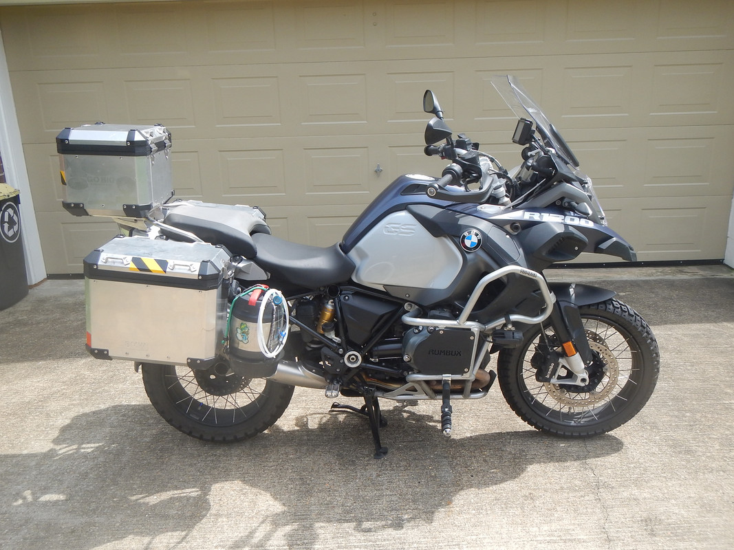

You can peg mount a hydration jug fairly easily by removing the passenger peg rubber, drilling one more hole in the peg and bolting either an aluminum mounting plate for a base to which you mount a container to hold your jug, or adapting something of your choice. It does get in the way a little bit when paddling the bike, but that varies by rider. I found it desirable to wedge the peg so it wouldn't fold up as well.

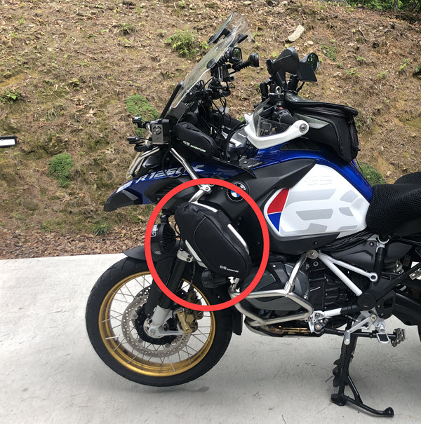

A couple of pics of a Bubba Keg install.
You will also want to consider some form of crash protection for the cylinder heads. They are not protected by the OEM system unless you count being torn off completely. The GSA in it's natural setting with stock crash bars. vvvv

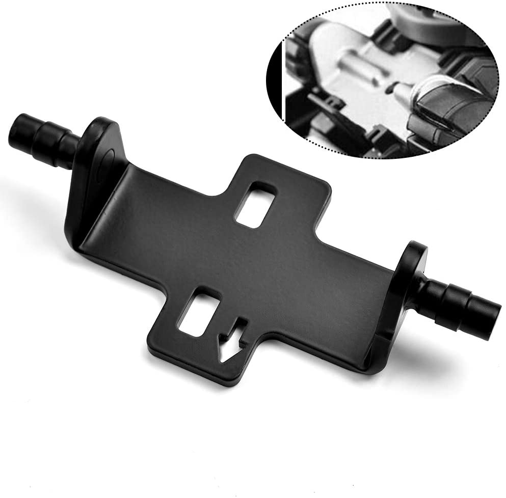

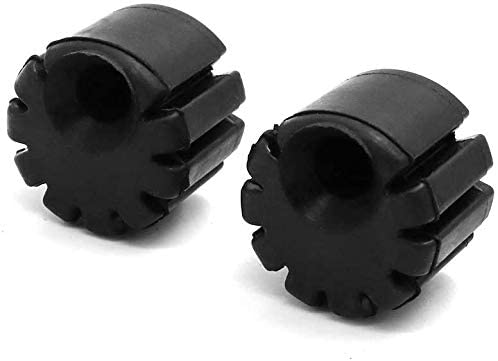

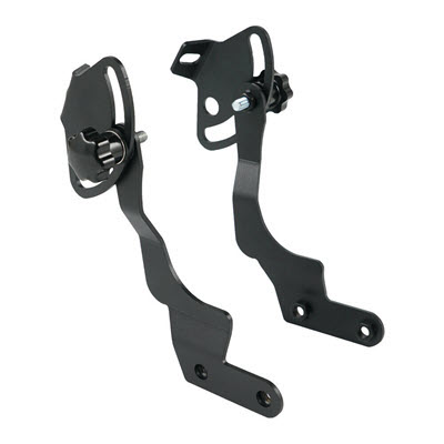

The first one is a replacement for the rubber on the seat high / low adjuster. As you can see the holes are not in the middle but closer to the side which makes the seat sit lower. Cost $15.00
The second item can go together with the firs tone above. It is a replacement for the high / low seat adjuster. It has longer arms and the parts where the rubber bumpers above are .8 inches lower than the stock ones. Cost $20.00
So together it makes a pretty big difference in the seat height especially the front part of a seat.

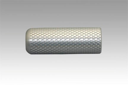

A couple more things I did after the changes in the above post where to find a low cost rider foot peg lowering kit and looked into a different seat.
I found a nice foot peg lowering kit for $60 that allows you to make many different adjustments to the foot peg location.

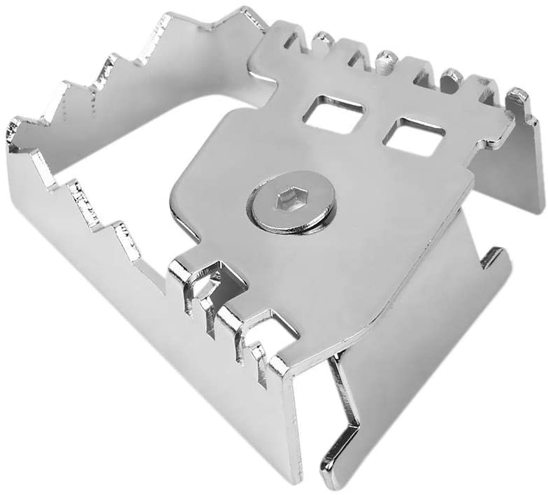

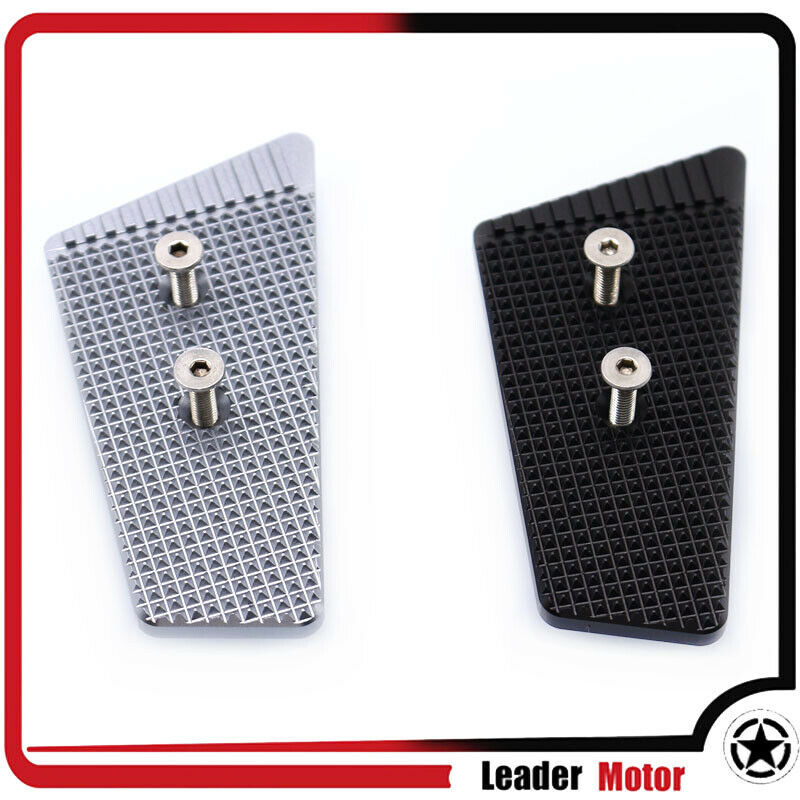

Once I did all of the modifications I noticed that my boots stuck out a little more ( mostly from the foot peg lowering kit ) and I had to turn my feet in to get tot he brake pedal and gear shifter. So I started looking for low cost options for brake pedal and gear shifter extensions.
I found two different brake pedal extensions that were cheap. $10.00 and $15.00
I also bought a gear shift extender from Ilium for $22.00.

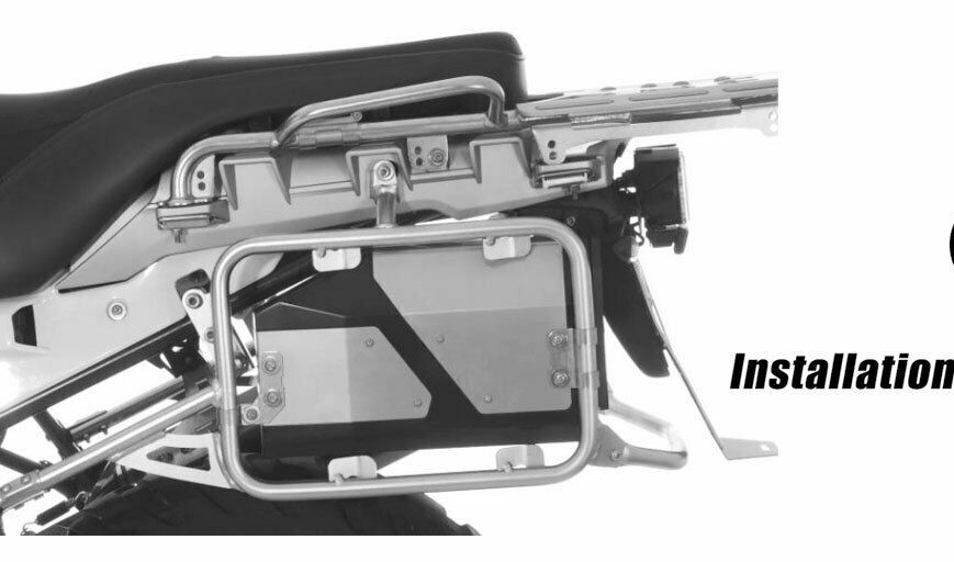

Nice low cost tool box - $60.00

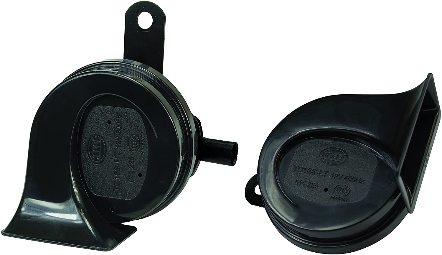

I added two Hella car horns that have the BMW plug and they work great. The are low and a high tone and cost $30.00. Now I sound like a car when I hit the horn. ;)

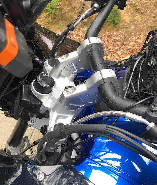

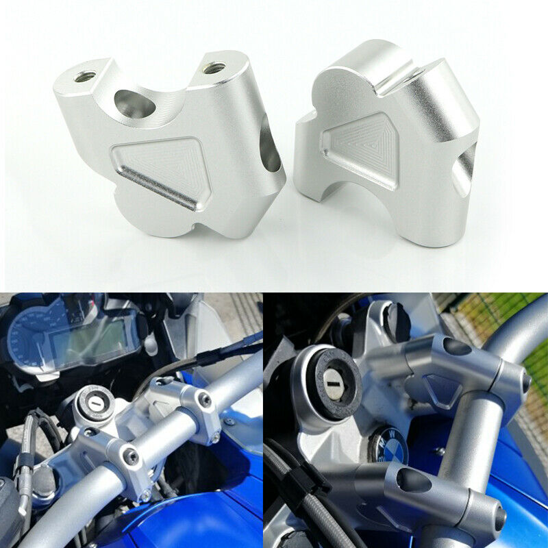

Another thing I did to get comfortable was to install risers for the handle bars. I first added a set of ROX risers, very nice, but I was still not feeling it so I bought another set of risers off of eBay and I installed both of them in a custom configuration. o_O
The first photo is the set of risers I bought on eBay. ROK riser photos are easy to find.
Look closely at the second photo of both sets of riser installed. This gave me a few inches of up and back for the handle bars.
