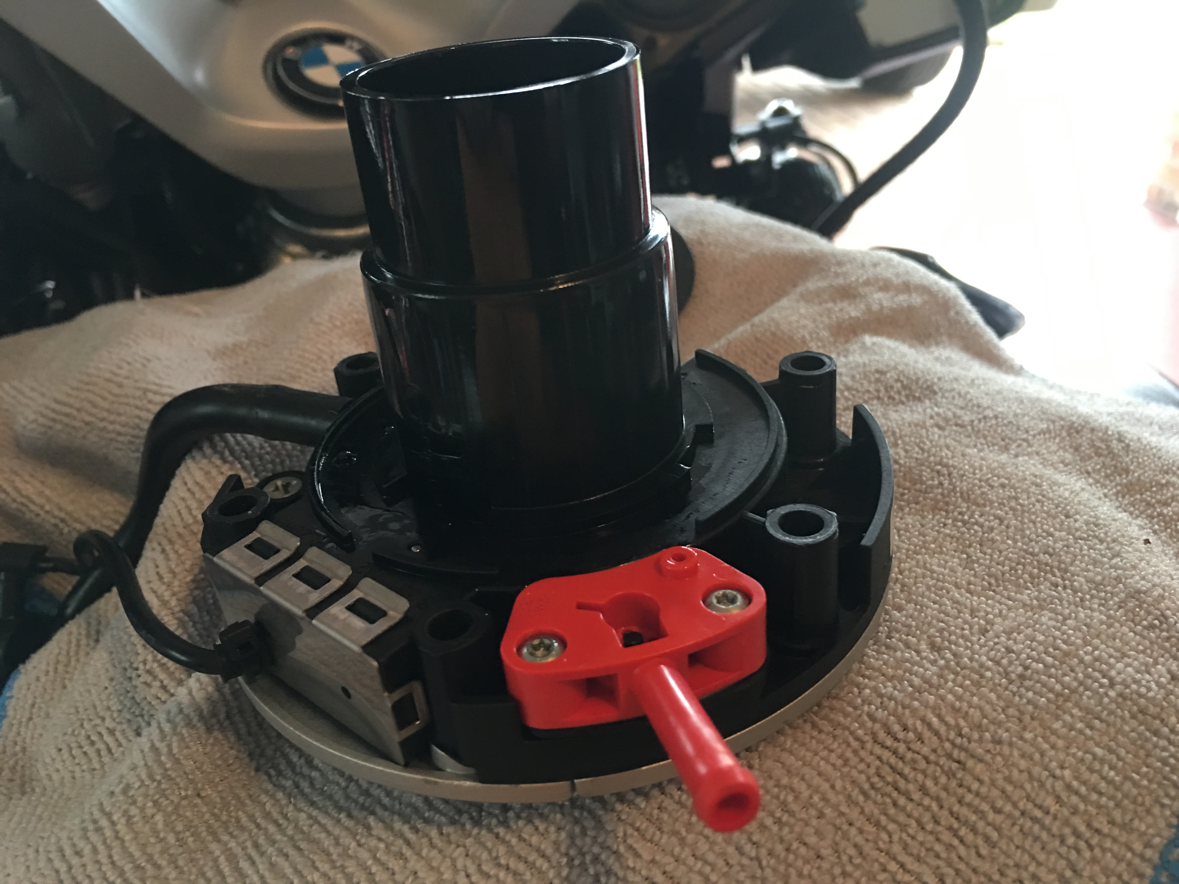

Many of us are using the idea from a guy on advrider who makes tanks under the name camel-adv.com and it has worked perfectly for me and many others. It is much easier than drilling and 100% reversible. The only important thing to remember is to NEVER close your aux tank fuel petcock. Explanation to follow. When the main tank drains fuel, it sucks in air to replace the space - instead of using your vent to suck in air, I use it to suck fuel from an aux tank and the aux tank has a vent placed higher than the fuel level, usually near the top of the filler neck. All you need to do is take off your right side tank plastics, find the red filler neck and on the right side remove the vent hose going to the charcoal canister. Place your fuel hose on that red nipple and you are done. It really is that simple. No error codes, no nothing. Remember, now thru your aux tank is the "venting," so if you have a shutoff valve to the aux and it is closed, you are going to suck and try to collapse your main tank. Also, if you have a vacuum leak, for example leaving your main gas cap open by accident, you will not suck from the aux tank. Last, but not least, in extreme heat (above 97) it WILL drain, but very slowly. Eric Bray has a slightly more complicated way to overcome this. I haven't bothered, and I've ridden in plenty of extreme heat. Still drained both tanks, but takes forever because the fuel in the main is expanding and actually pushing on the aux fuel instead of sucking. With the above method, when everything is working properly, your fuel gauge will not register any consumption until the aux tank is empty. There is a BB under that red cap that can be removed and it might help. I've done this both ways and it doesn't really make much difference. I've attached a few pics and a link to a writeup someone posted on adv. Sadly, I think the pictures in the adv forum are gone.

AUX tank line goes on this red barb that is the vent for the main tank.

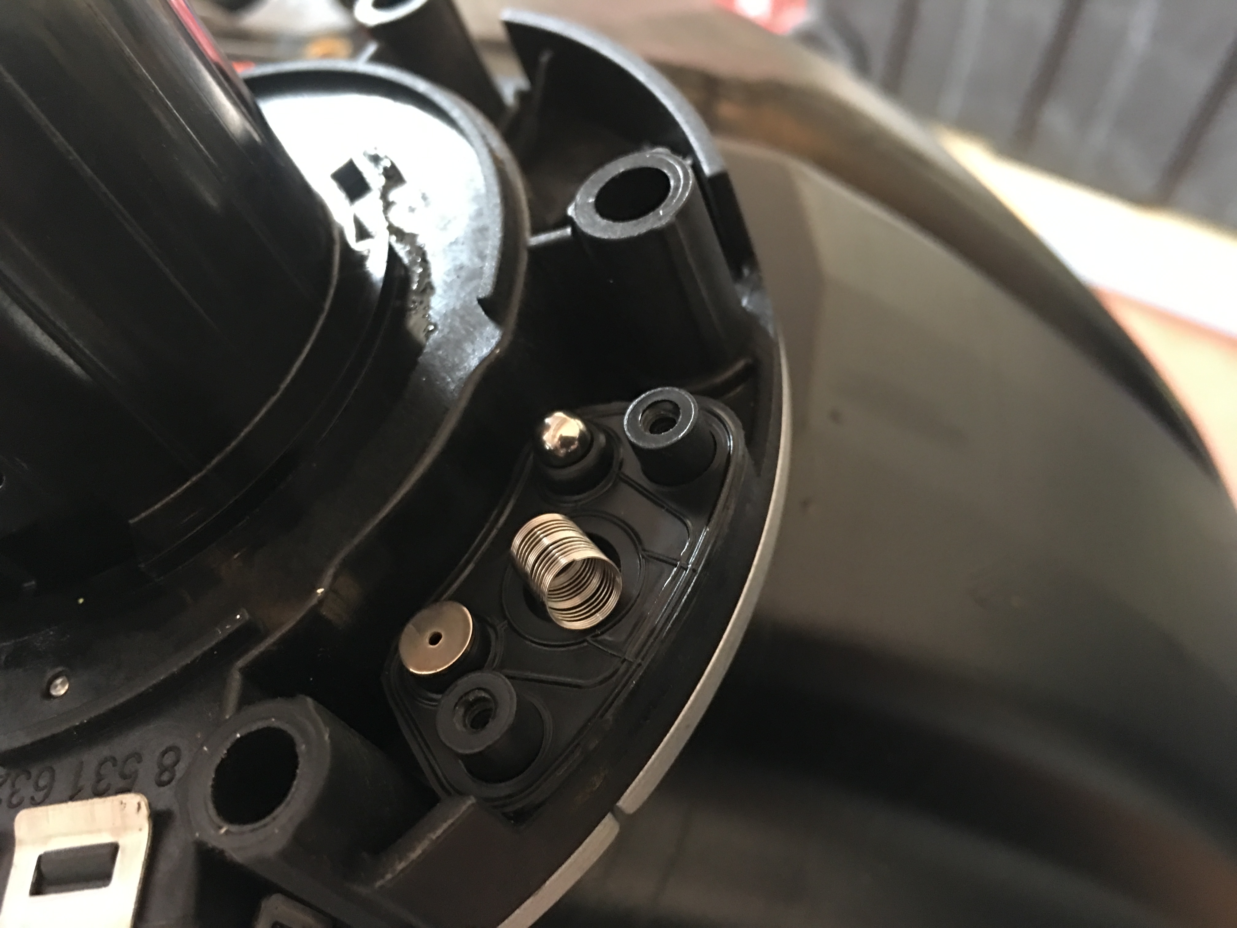

Thanks Greg, that sounds like a nice clean system, we don't have the charcoal canister in the UK, but obviously, we have the same red filler neck.
I take it the second pic is the 'BB' you mention, not sure what it is, but you mention it works either way...thank you.
Yes, that is the BB. I removed mine to limit any chance it could reduce the flow.
Cool! Thanks Greg

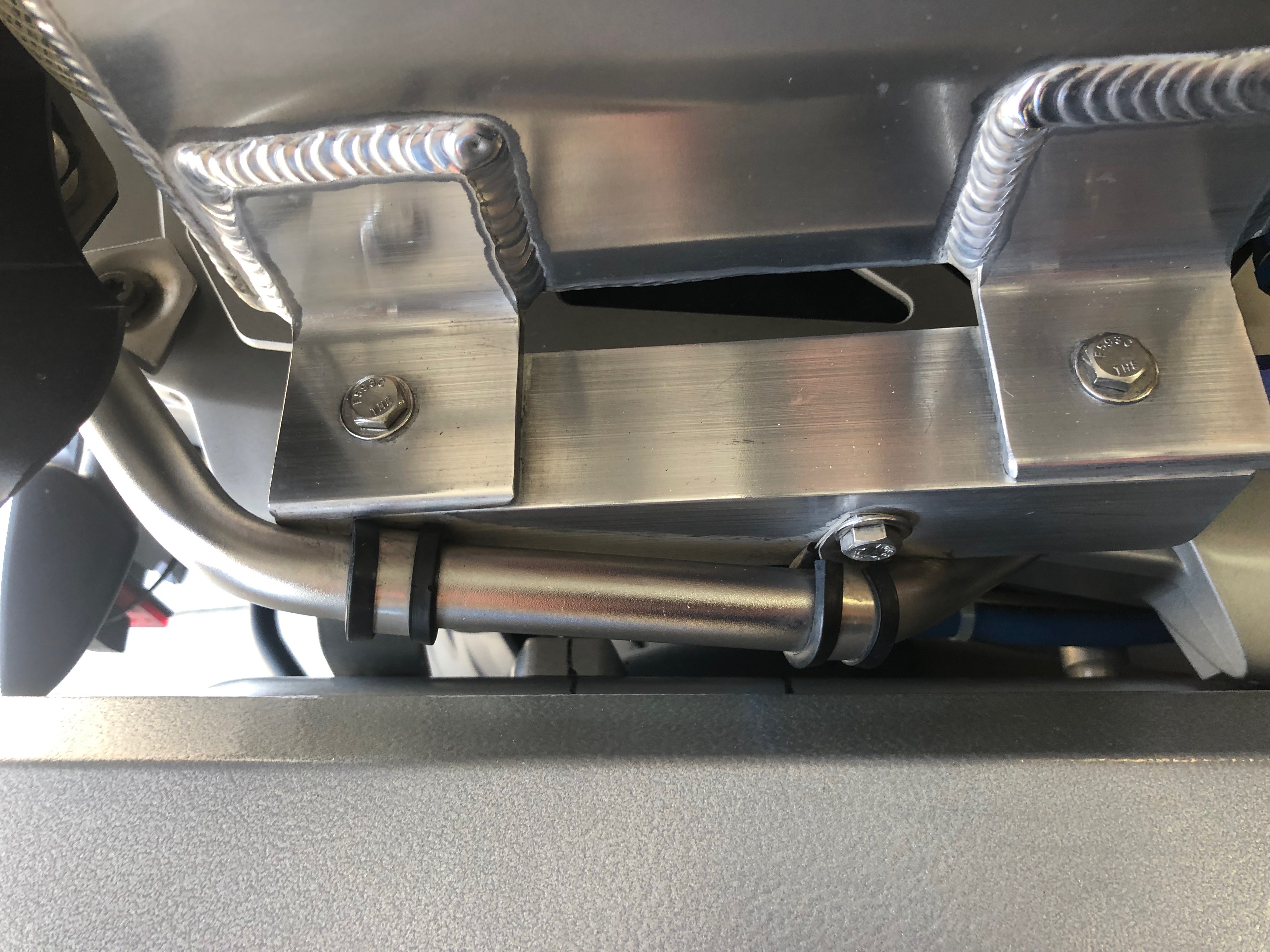

I ran the fuel line under the seat and then under the gas tank up to the front of the tank and then up the neck. You have to remove the center piece of plastic to get to the red barb were you connect the fuel line.
I am going to upload a photo that shows the fuel line running under the gas tank.
Thanks greg, did you put a clamp on the plastic barb?
