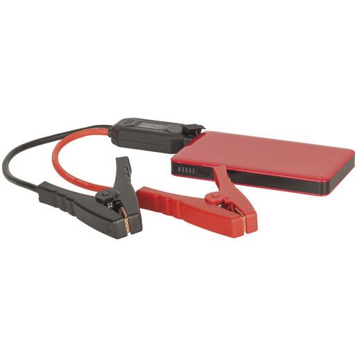

Maybe buy and carry one of those new lithium battery jump starters. They are about the size of a large cell phone. They will get you started again, and then you will have to decide whether LEDs or heated gear is more important at that moment. But you will be mobile.
I just installed a volt meter on it, haven't got to test it out yet. I like the jumper battery, have to look into that one.
