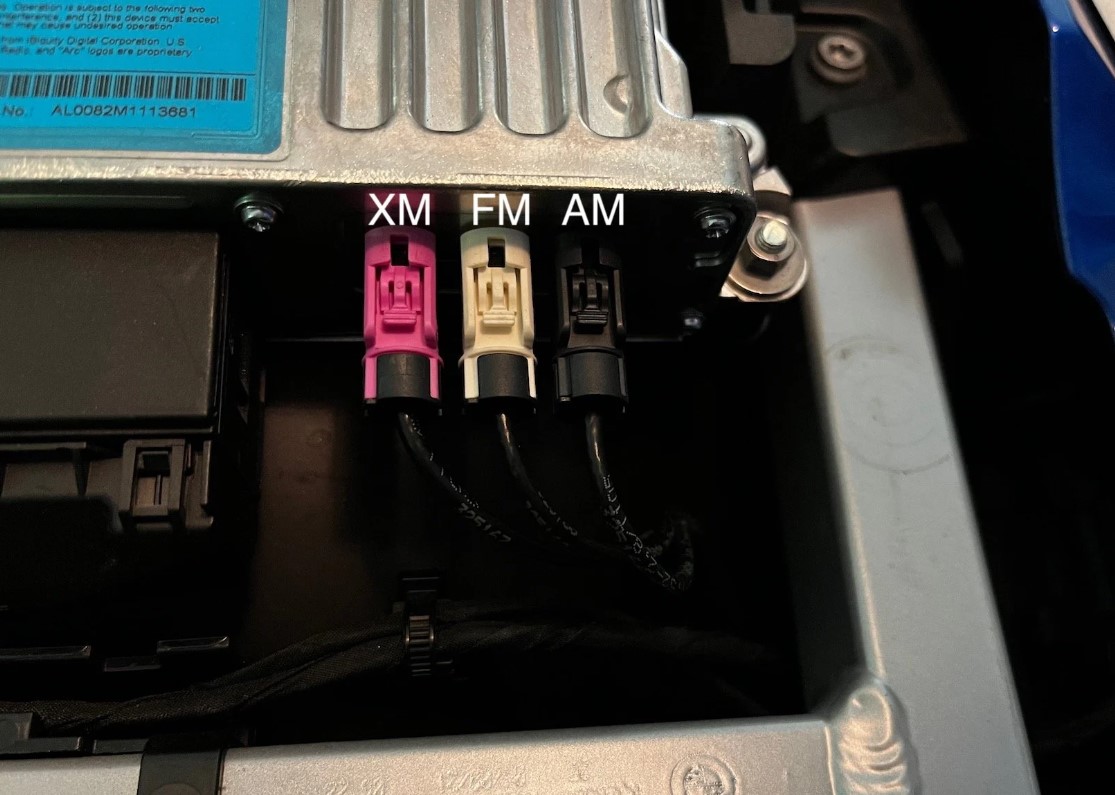

No, I bought an XM antenna and connected it to the radio and then put the antenna on the dash shelf. If you leave the antenna under the dash shelf it will suck. Actually, it already was getting bad reception with nothing on top of the antenna. That is why I replaced the OEN XM antenna with one I bought for $25 and then put the antennal on the dash shelf. The XM radio reception improved dramatically.

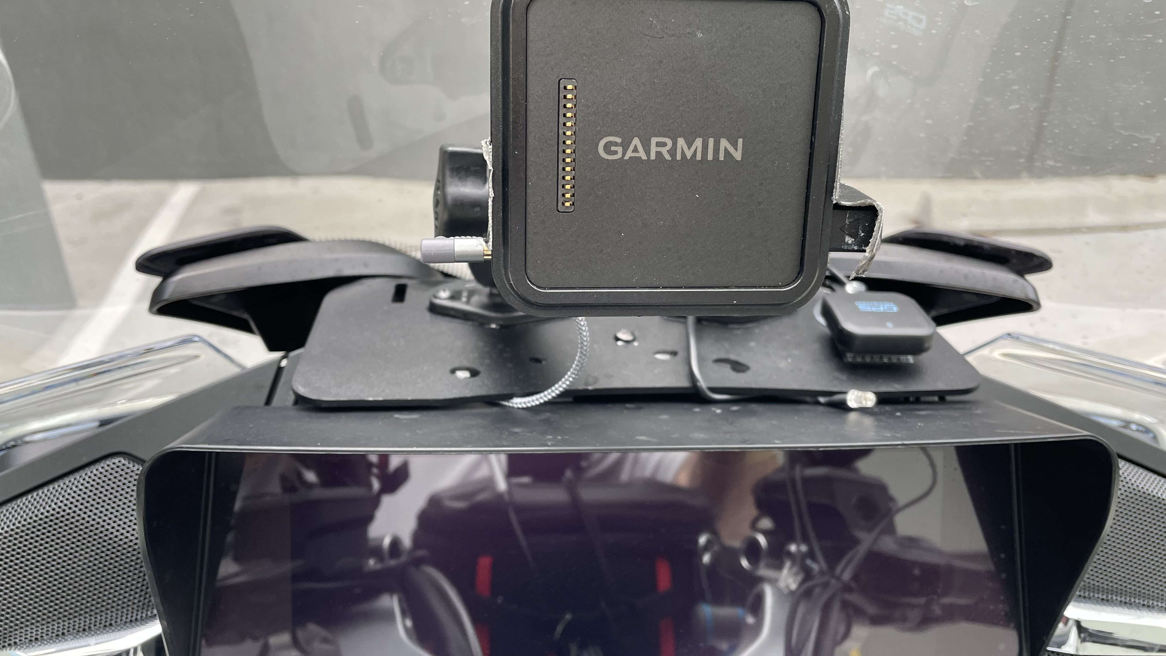

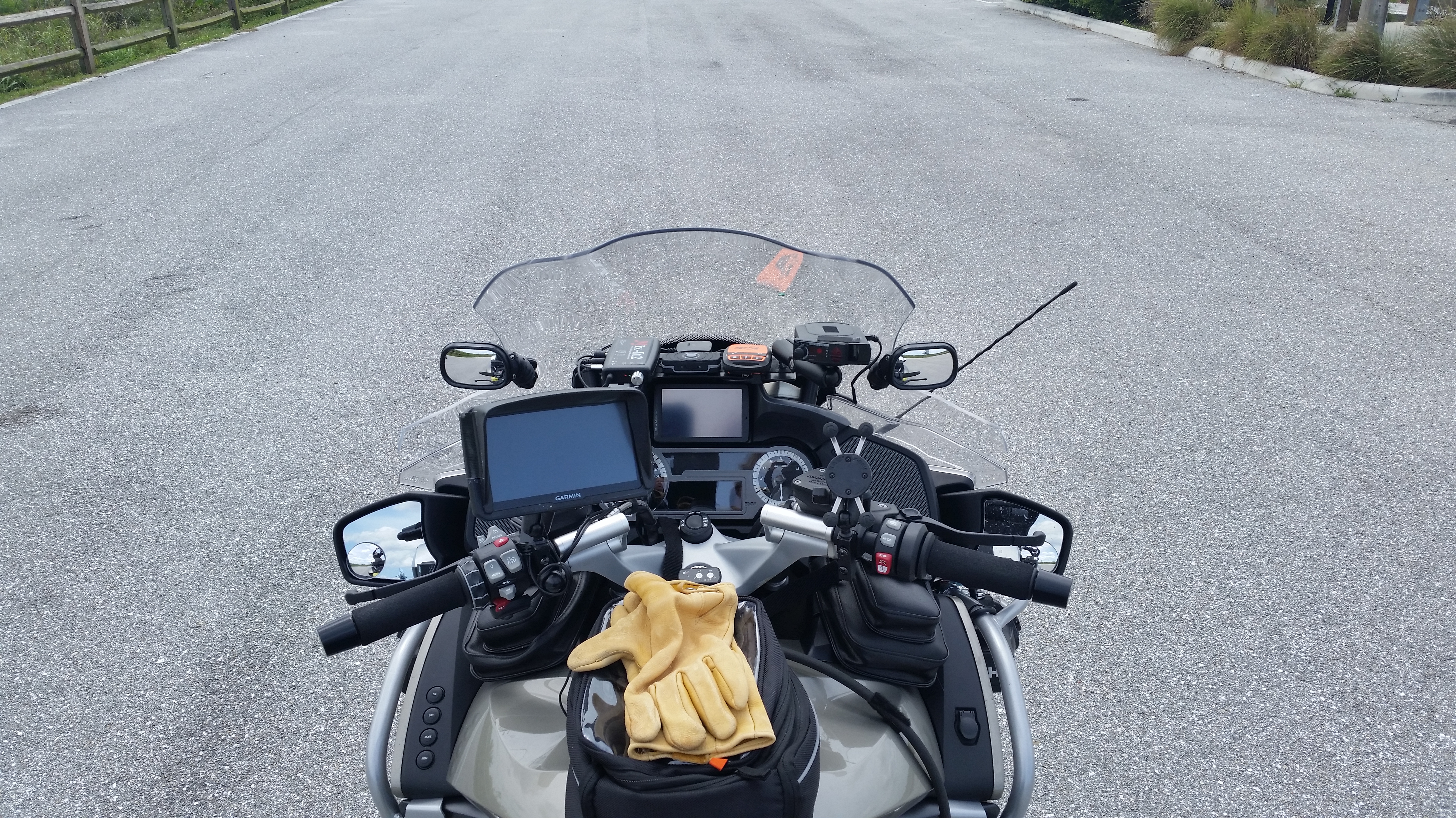

Here are a couple photos on the XM antenna on the dash shelf.
One this photo you can see the XM antennal behind the Sena device on my 2016 RT, maybe you will need to zoom in.
One this photo you can see the XM antenna on the right on my 2023 RT.
The is where the XM antenna is plugged in and you would plug in your own antenna.

Yes, for the 2023 RT I did have to make modifications because of where the XM antenna was mounted. I removed all of that and then had to drill a hole to complete the mount.
