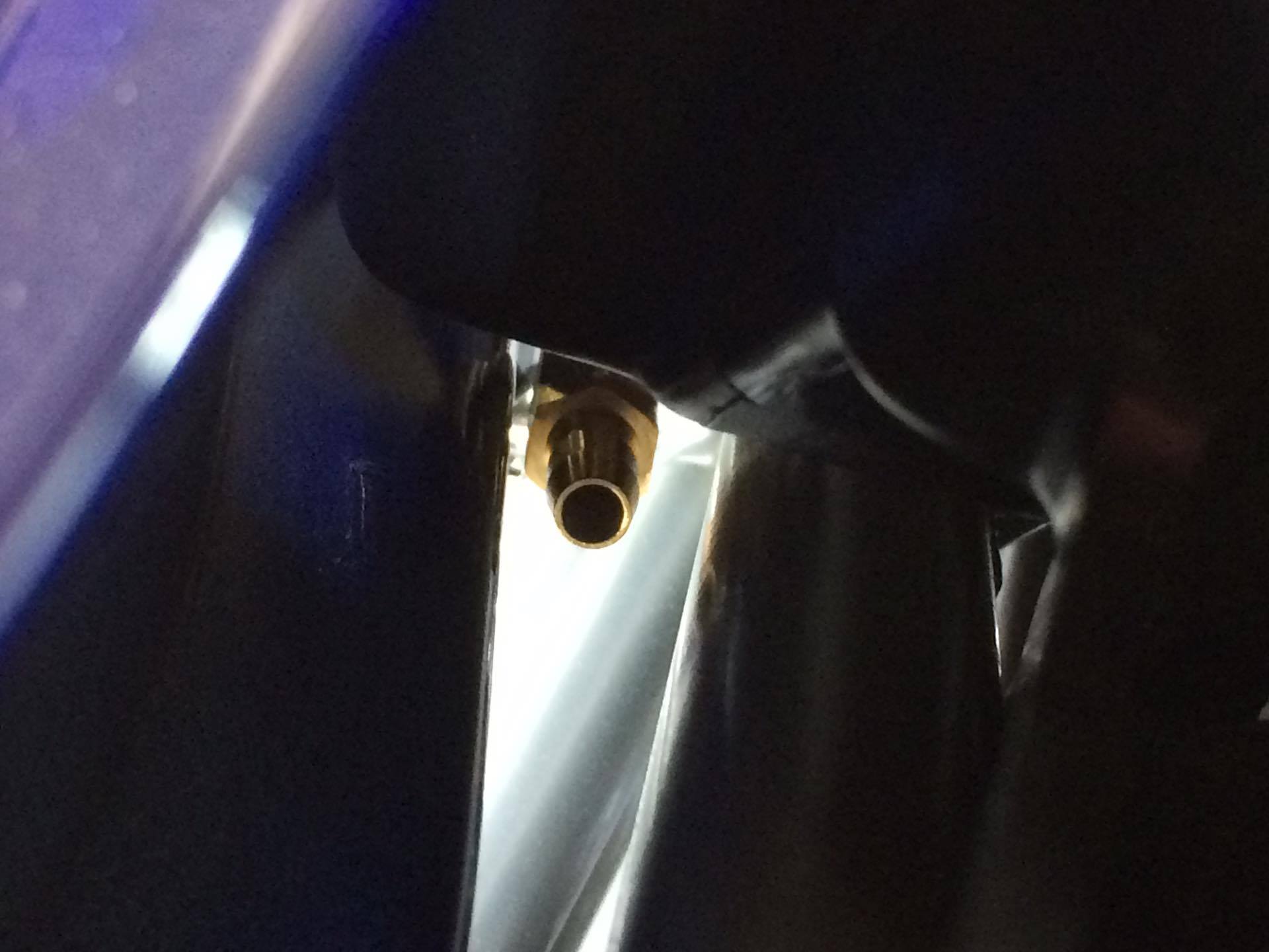

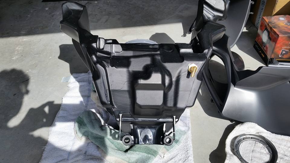

I mounted a Langford tank on my 2016 RT and drilled a hole in the tank for a bulkhead fitting. It is a very tight spot and no room for error. See photo below.

RT Tank Bulkhead Fitting Photo
